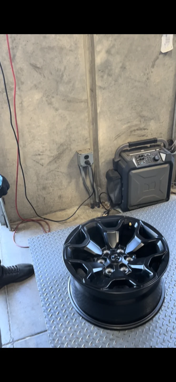

Can anyone out there for certain confirm the Rebel wheel weight?
In all my searching I have found approximate guesses and 1 guy claiming 26.7 pounds, which seems too light.
The Peasant Edition TRX wheels are 30lbs, so 26.7lbs is very believable.

That’s the exact post I’m referring to. 26 pounds seems to be very light. And I’ve seen elsewhere of ppl estimating upper 30’s.
The Rebel wheels are 8" wide and the TRX wheels are 9", which would account for the 3.3lbs difference. The TRX beadlock wheels are ~40lbs. No way are the Rebel wheels almost as heavy as the beadlocks.
My tire and wheel assembly measured 80 pounds on a scale. According to custom offsets.com the dura-track weighs
56.94 pounds so that would leave a wheel weight of 23 pounds.
edit:
Amazon states 45 pounds, so 35 pounds for the wheel.
I might lean towards amazons weight.
edit2:
Just went down a rabbit hole, almost did not make it out...
The stated tire weights on line are all over the place.
