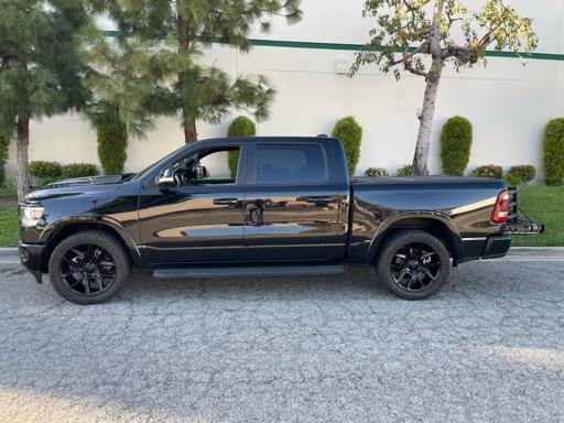

Here are the 285/55’s. On a non leveled truck I think the 295/50’s would be perfect. If you are level/lifting it the 285/55 looks great imho. I got alot more sidewall and extra height without any fit hassle. The 285/55 would likely also fit a non leveled truck but they might rub in entry/exit mode. The wheels looked super tight when lowered to that. This picture is in aero mode. I have zero complaints on the Toyo’s btw. Ride character is almost exactly the same as stock. To describe the difference I will say in a straight line it’s the same. Turning, the front end isn’t as responsive but that’s to be expected with the larger heavier tire. However it’s still great. I went from a sports sedan to a luxury sedan in terms of handling if that makes any sense.
Looking for the same exact set up! What was your MPG hit?
