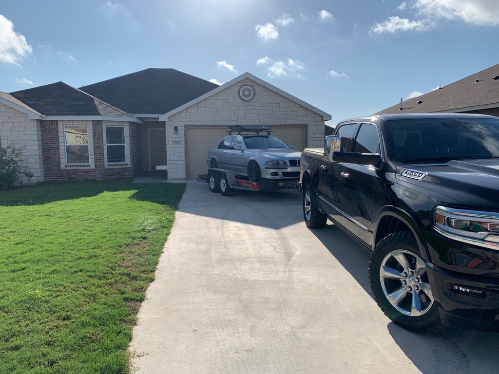

Pulled a Uhaul trailer with a car loaded up with junk which weighed 7400lbs according to the Cat Weigh Scales.
Truck bed was loaded with another 1000lbs of stuff.
Drove through the Smokey’s and had absolutely no issues with the 3.21, and averaged 10.6mpg.
