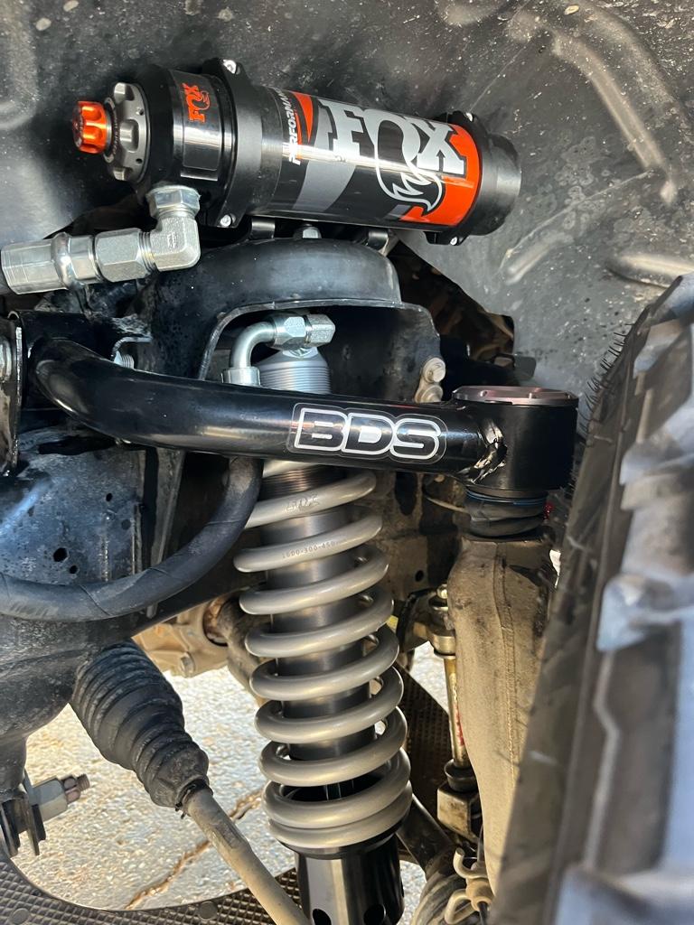

BDS 3” lift has been installed. Feels much better but I’ve only driven it on pavement. I’ll have it out on the lease rods tomorrow. I did still notice a bumping sound on hard right hand turns in the front drivers side that was there before. Drives me crazy so I’ve got to figure out what it is.

Looks good. Mine gets installed in the next two weeks. 🤞 What wheel/tire combo are you running?
For the clunk, have you checked your front sway bar bushings?

Looks good. Mine gets installed in the next two weeks. What wheel/tire combo are you running?
Stock 20” wheels with MT Baja Legend EXP 295-65 R20.
Sway bar bushing will be replaced soon. Im thinking about ordering the Hellwig sway bar.

Any spacers on the stock rims? From your pic, it looks like maybe 1/4" of clearance from the UCA. Also, any rub from the tires?
I'm just going to change my front sway bar bushings when I do the lift. Going with Energy Suspension.
No spacers and yes there’s about a 1/4” clearance. I think there’s a little more clearance on the BDS UCA than there was with the RC. I did have some slight rub before mostly in reverse but did not notice any this morning when I backed out.
I also had a little in the upper fender well with the old set up if I hit a big hole or something to hard. I’ve put almost 60k miles with this size tire. First set were Nitto Recon Grapplers now these. I will say the drive this morning was amazing with this set up. I got to test it out on one of the roughest roads I drive on. It’s around a 12 mile drive on one of the roughest dirt roads you can imagine and I didn’t have to dodge holes the whole way.
