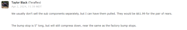

Looks like Teraflex sells front/rear bumpstops with their lift kit for 5th Gen. I'm only interested in rears, but I hit them up about information on the rears length and cost and where to buy.
