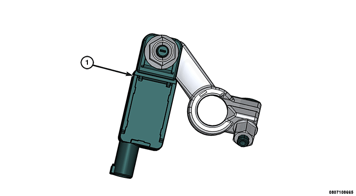

The Intelligent Battery Sensor (IBS) (1) is a device used to measure battery current, voltage, and temperature whose outputs are used in the energy management strategy.
The mechanical portion of the IBS is comprised of the battery clamp for the negative terminal and a captured bolt to attach the ground cable to. The functional tasks include establishing the electrical contact between the body and the negative battery post, housing the electronic module (actual sensor element) and the provision of an adequate thermal contact between the sensor system temperature sensor and the negative battery post. The mechanical portion of the IBS also protects the sensitive electronic components from external influences.
The IBS is mounted directly on the 12 volt DC battery’s negative post. The battery post clamp nut is a captive nut and the stud will break if the nut is removed.
OPERATION​
The Intelligent Battery Sensor (IBS) contains a low value resistor, or shunt. The shunt creates a voltage drop, which is read by an internal microcontroller to determine the current flow in and out of the battery. In addition to the shunt, the IBS contains a sensor to monitor the battery’s temperature. Data gathered by the IBS, including temperature, voltage, and current measurements, are transmitted over a Local Interface Network (LIN) communication bus to either the Body Control Module (BCM) or the Powertrain Control Module (PCM), depending on the application. The IBS serves two primary purposes. The first is to provide the PCM with both immediate and historical battery information, so the PCM can precisely control the charging system. Precise charging is important on a vehicle equipped with an Absorbent Glass Material (AGM) battery, because they are especially sensitive to overcharging. The second purpose is to provide data to the BCM for operation of the load-shedding feature. A fused power circuit and the LIN bus are connected to the IBS though a two-terminal connector.

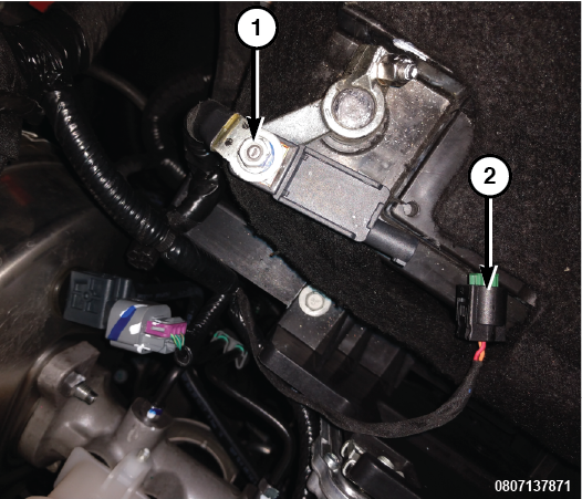

BATTERY DISCONNECT AND CONNECT - SINGLE 12V BATTERY SYSTEM​
NOTE
The graphic in this procedure depicts a typical negative battery cable and Intelligent Battery Sensor (IBS) connection at the negative battery post. The location of the battery and orientation of the cable eyelet connection to the IBS can vary between vehicles. Refer to the Description and Operation for the battery specific location.
1 - Ground Terminal Nut
2 - IBS Wire Harness Connector
BATTERY DISCONNECT PROCEDURE:
  1. Remove the ground terminal nut.
  2. Remove and isolate the negative battery cable eyelet from the IBS. This will isolate the 12 volt from the vehicle electrical system.
    NOTE
    If removing the negative battery cable clamp from the battery post instead of removing the negative battery cable eyelet, the Intelligent Battery Sensor (IBS) wire harness connector must be disconnecting prior to removing the cable end. Failure to disconnect the IBS wire harness connector can lead to damage of the IBS wire harness connector.
U
